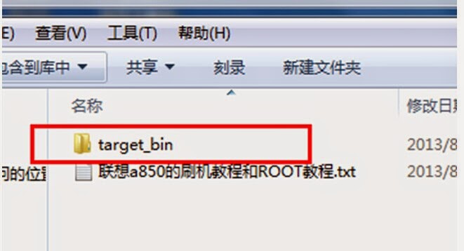

2. Unzipping the ROM firmwave that your download first, and you will find a “target_bin” file, see picture as follow:

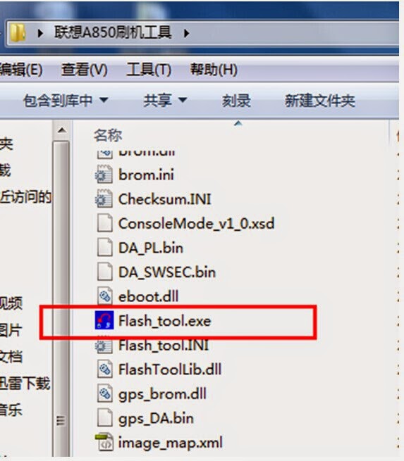

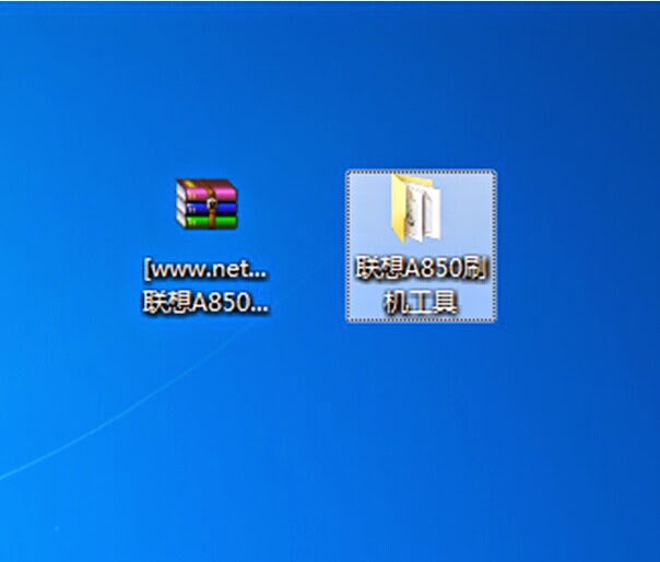

3. Unzipping SP_Flash_Tool that you download before. check it as follow:

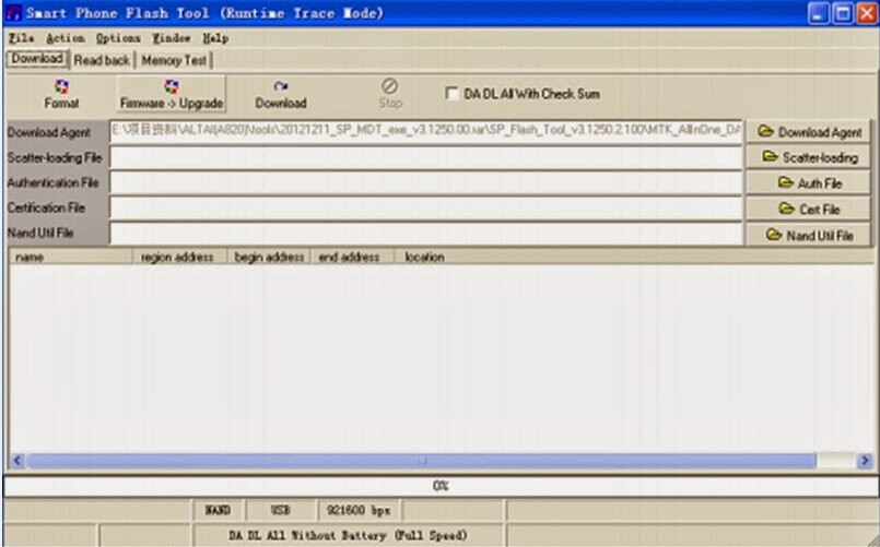

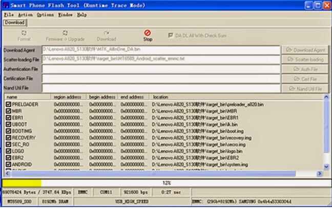

4. Then find the “Flash_tool.exe” in your unzipping SP_Flash_Tool, you click it double to run. as the picture show,

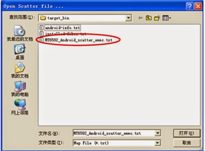

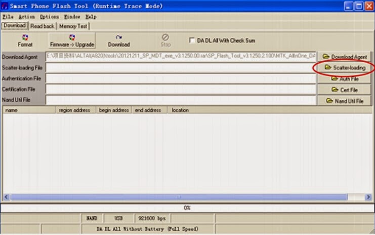

5. Click the “Scatter-loading” to choose the corresponding file.
6. Then choose “MT6573_Android_scatter.txt” in “target_bin” that you unzipped just now.( Note: the name of this file is different from other firmwaves)

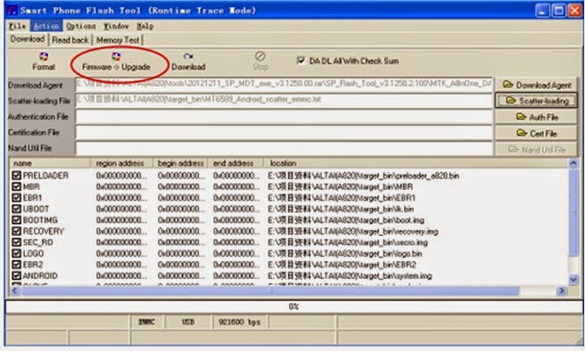

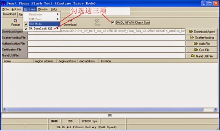

7. Next, click and check “DA DL All With Check Sum”, and check “name”, then choose and check them all.
8. Click the button “Firmware Upgrade”.
9. Under the switch-off state of your smartphone, connect your smartphone and computer by using USB cable, then download automatically, don’t need any operation, like the picture showing, it’s downloading( the time is a little long when downloading, please wait with patience)

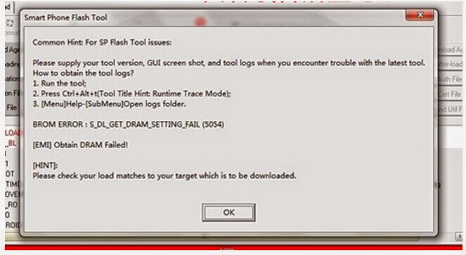

If you face this situation, please unplug your usb cable to flash again, if it doesn’t work, try to reswitch on your computer.

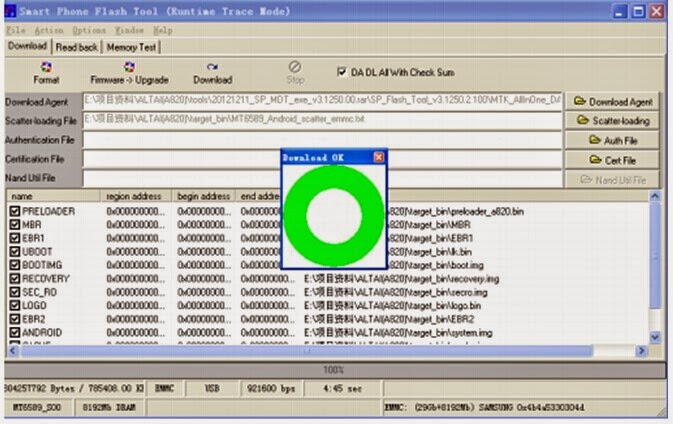

10. Until you see the following screen, now your usb cable is disconnecting.
11. Flashing your smartphone is over.
